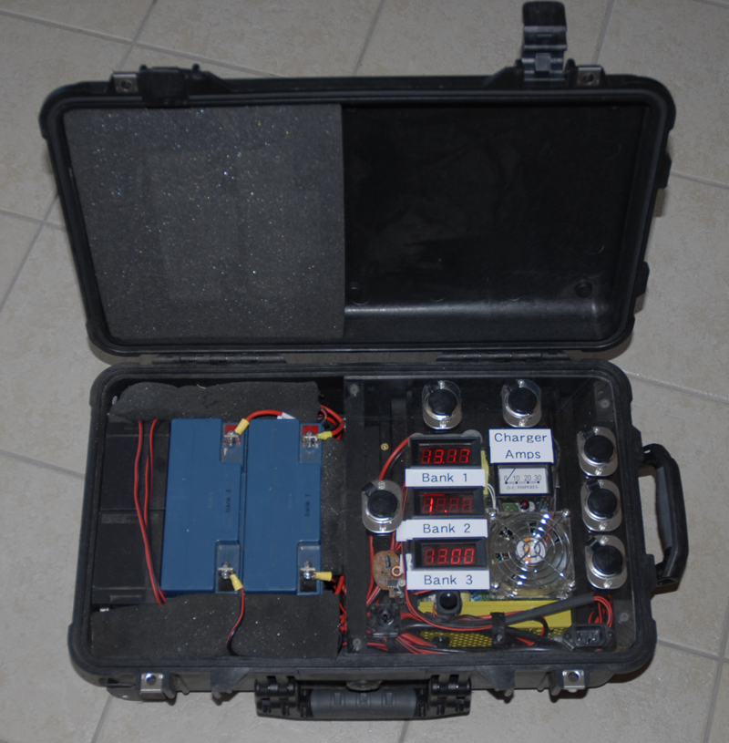

All good advice. Prior to the remote setup I'd go to the field for several days and power was always an issue. I drained the car battery in the field more than once and needed to do something different. Here is an image of a DIY 3-bank setup with charger power-supply and both "visual" voltage monitoring and "computer" voltage and current monitoring. It is very heavy 75pounds, used AGM deep cycle sealed batteries, but worked. Three banks with 21 amp hours each. One bank for cameras, one for computers, and the third for mount and focus.
Best,
Dave

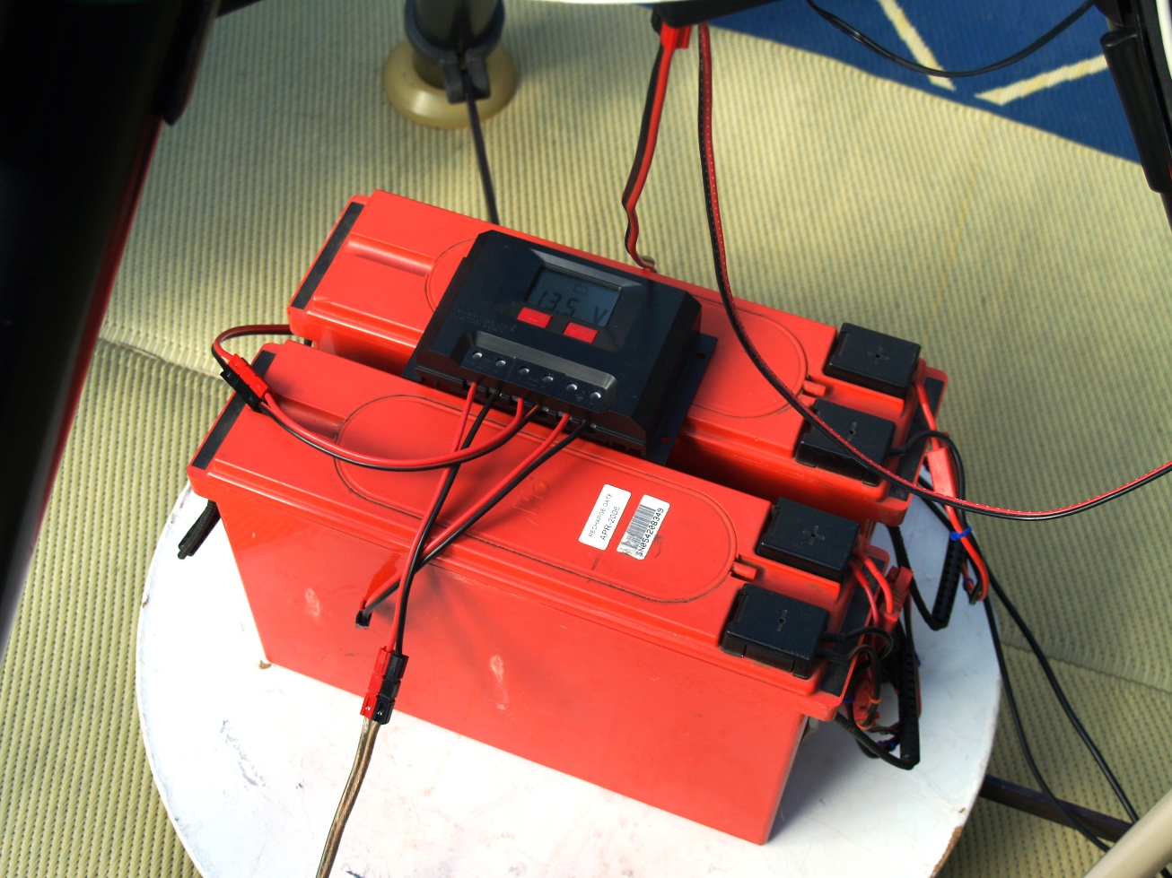

When I go out to a remote dark site I tend to stay for several nights so I use 100A AGM batteries designed for commercial UPS applications. I charge during the day with a 150 watt solar panel. The batteries power the scope, CCDs, computers and all the other stuff we use while imaging. The charge regulator has a handy display which shows voltage and amperage while charging or discharging. I have a second panel for the "Moonlight Manor". I have spent as long as 10 nights "boondocking" at TSP, RMSS, ESP and trips to the middle of nowhere. The large AGM batteries are not cheap and heavy but it sure beats a dead battery when you are 50 miles from a power plug and they are cheaper and quieter and less hassel than a generator.
John
