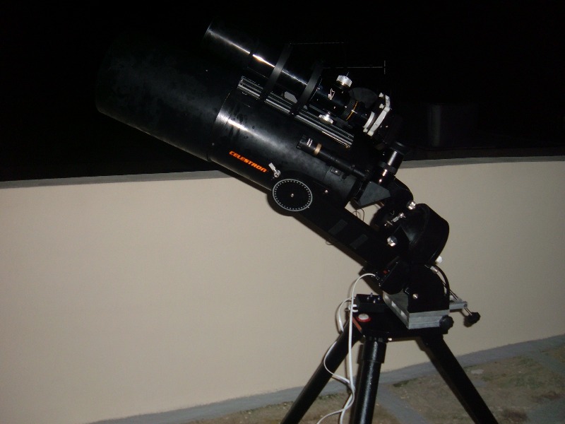

I own a Celestar C8 on a standard wedgepod which I modified to improve for CCD imaging. I added latitude and azimuth fine controls, however the wedge is still not stable enough for me to be pleased. It giggles a bit when adjusting for polar alignment. I have a Zentithstar 66 piggybacked on the C8 and no counterweights as yet. I use digital setting circles which work quite well. Unfortunately I find that the RA drive does not turn un-aided due to the weight of both scopes. I've heard of people using elastic to rectify this problem but I don't feel that its an adequate solution. Moreover, my wedgepod does not have adjustable legs and is very heavy since I filled the legs with sand to make them more stable.

bferry's attachment for post 41446

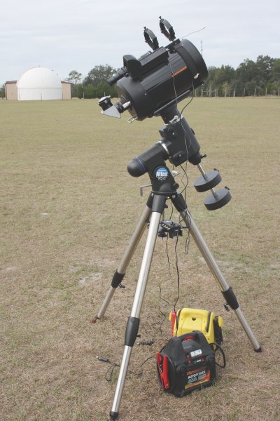

Next up, steadiness wise, anyway (it's very inexpensive), is the Atlas EQ6. Great mount. I love mine. The software is the same as that on the Sirius, but, like the Sirius, you can run it with the wonderful EQMOD driver instead. The attached pic shows my Atlas/C8 at Chiefland.

rmollise's attachment for post 121353
