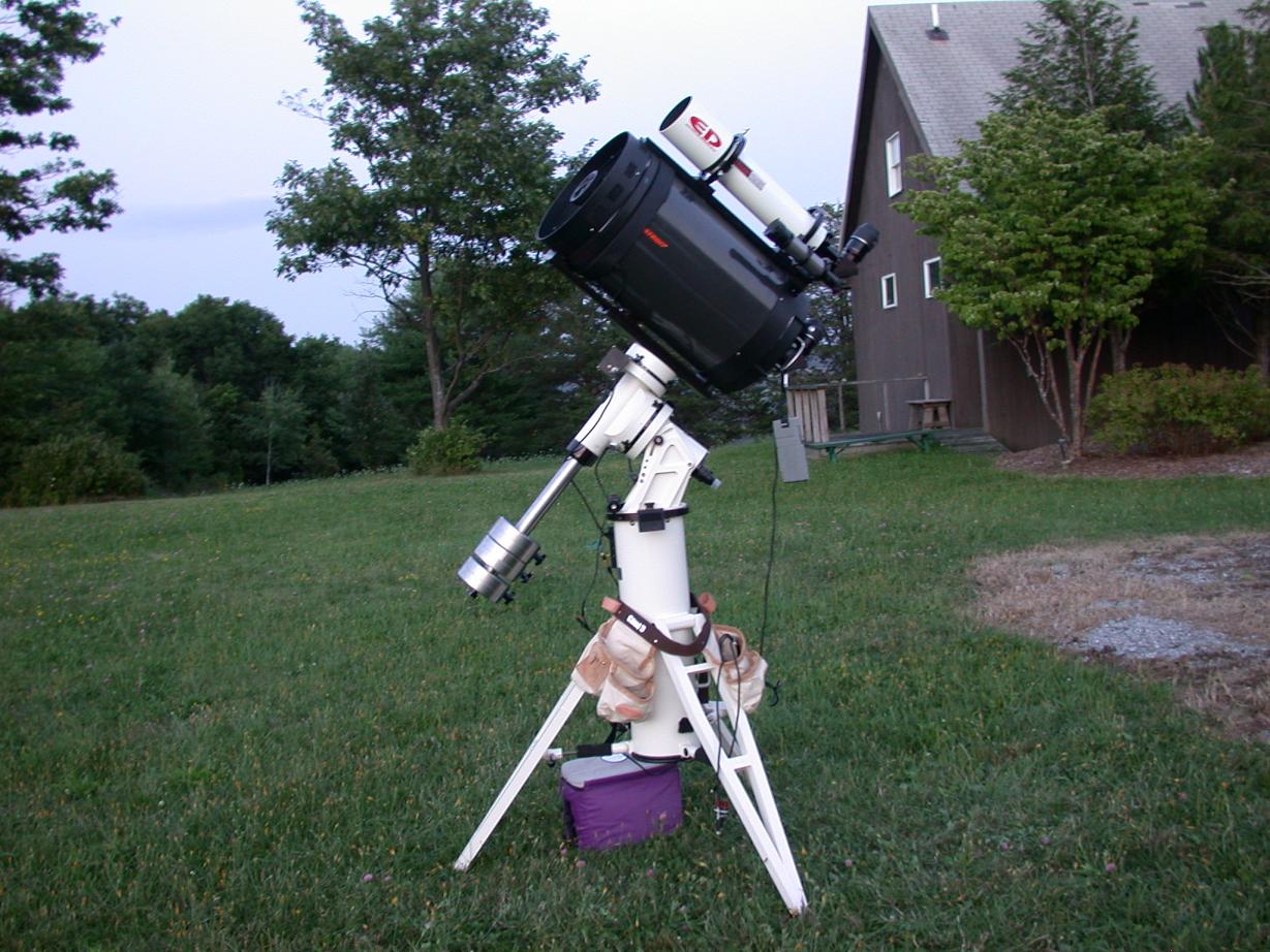

As a matter of practicality I don't think the 5" scope would do too well in the rings with delrin tipped screws that you have put them in. I'm only "marginally OK" with their performance on my four inch. They get to be hard to adjust as the weight of the refractor increases. I think I'd want my FS128 (not shown in pic, that's the four inch) on solid rings where the adjustment takes place with some kind of cradle or better support.
I didn't *draw* this setup afraid I had to put it together the old fashioned (and expensive) way....
regards
Greg N

Well looking at the design again there does seem to be room for a dew shield; not for the entire OTA, but maybe enough. In days of yore I used to wrap my entire OTA.
The other thought is whether the design allows for the whole affair to be moved far enough "up". With a refractor and XW40 my C14 rides "very high" in the AP saddle. Mounting photographic equipment might push it higher still. Have you done a calculation to make sure that your design allows for the weight to be moved up far enough? Otherwise a counterweight would be needed as an accessory, possibly design a clamp on for the lip of the OTA.
BTW I like the Tak colors on the C14 and the dark colors used by the company are definitely sub optimal.
One interesting design consideration is whether you could have some kind of crank or ratchet system for balancing so one doesn't have to "slip and slide" with all that expensive crap on the mount. I'm not sure it would be worth the manufacturing complexity, but it's an idea.
regards
