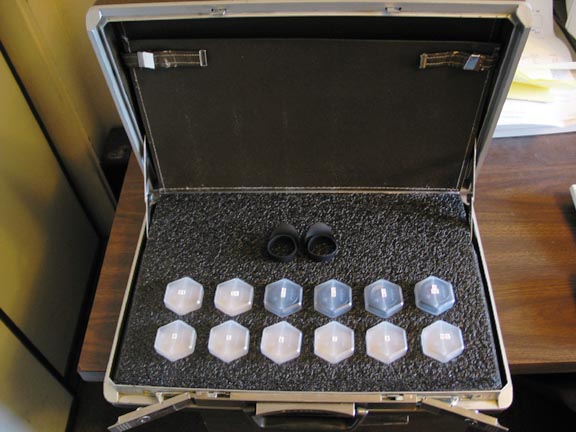

I use a hole saw that is used for wood or metal mounted in a drill. They are available in all sizes at the local tool or harware store. You can buy a full set from 5/8"-5" for about $10. They cut well and will do a nice job. Here is a case that I cut 16 holes in for my Ortho's and Ultrascopics. The round holes were for the size of the bolt cases.
Floyd
fblue's attachment for post 81806
