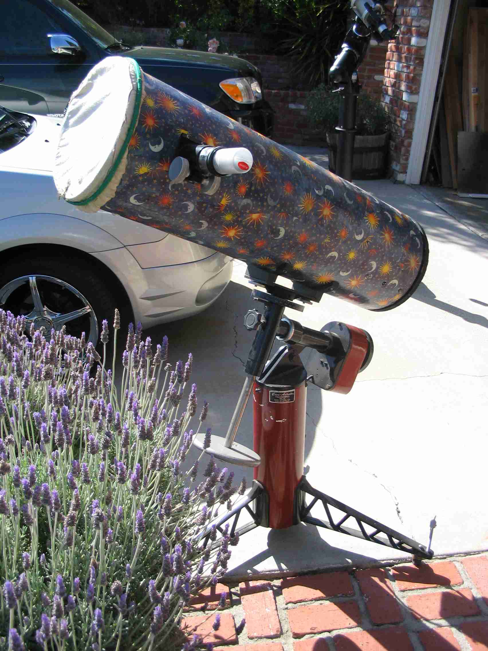

Im buying a 10" meade telescope on a GEM...with perfectly working clock drive...but I want to add a goto system to it..so I assume I'd need to buy a seperate mount that has goto capabilities. Does anyone know of any compatible mounts I could buy, for the most affordable price, that have goto for a 10" reflector? ive looked everywhere...i havent seen any under 1,000....grr...

bigtasty25's attachment for post 36431

I'd say forget goto for a scope that size in that price range. However, if you can be satisfied with "push to" there may be digital setting circles that fit or that could be adapted to that mount. If so (I suspect most any GEM could be fitted with them, given enough ingenuity) someone will surely know about them and be able to recommend a model and give advice on the encoder installation.
Digital Setting Circles will align much like a goto, then give you directions which way to push the scope, thus the term "push to."
Posted 03/28/2007 12:59PM #2
I'd have to agree with Roger. While you can convert the mount you have to GoTo, it's usually not a simple "bolt-on" conversion - it will take a bit of ATM work. Additionally the mount will need some items - such as a tangent arm for the dec shaft. You are talking arond 1500+ in most cases.
If you want to switch mounts, the cheapest is something like an EQ-6, but a tube of that size is probably max. I'd say go with the "push-to" set-up.
