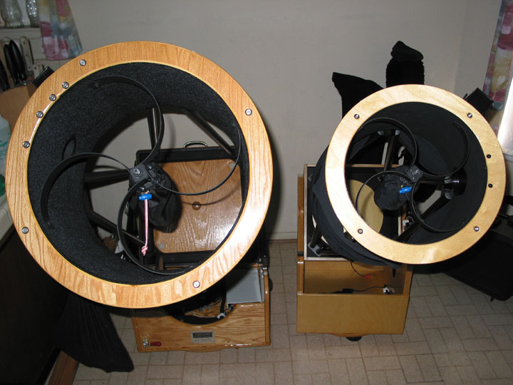

You could buy a curved spider to replace the original one and the spikes will be gone.
Or you could replace the spider with a thin bladed straight one and reduce the spikes.
fblue's attachment for post 115654
