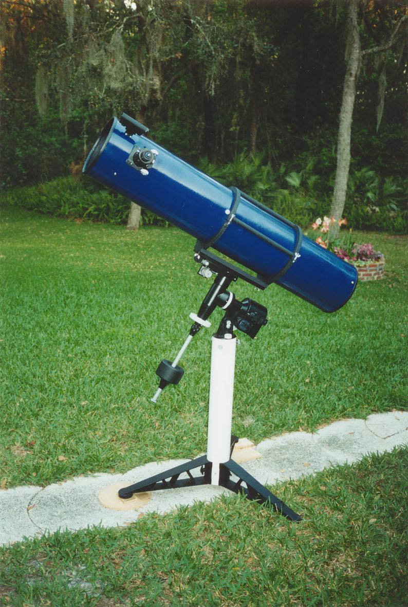

For what it's worth, the attached photo is my 8"f/6 that I recently completed. The mirror is homeground from 7/8" plate glass. The tube is sonotube that I stripped away the wax inside and outside and then fiberglassed. The focuser is 2" JMI, 1.65" diagonal. The mount is TAL2-M Russial GEM. At a recent starparty I compared imaged of Jupiter side by side with an AP 5" f/6, the new one. I will readilly admit that the contrast was slightly better in the refractor, but not 3000.00 worth!! Sharpness was about equal in both. Image brightness was much higher in the 8", as expected. I would consider my mirror good to excellent, but nothing to rave about. Can't wait to get my newly finished 10" mirror in a tube unit!
Walt
