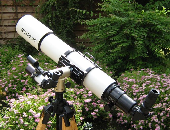

For visual use I'd highly recommend the Swiss AOK mount. I'm using it for four years now without any problems up to any reasonable mag.
See the pic.
Andreas
andydj5xp's attachment for post 137580
