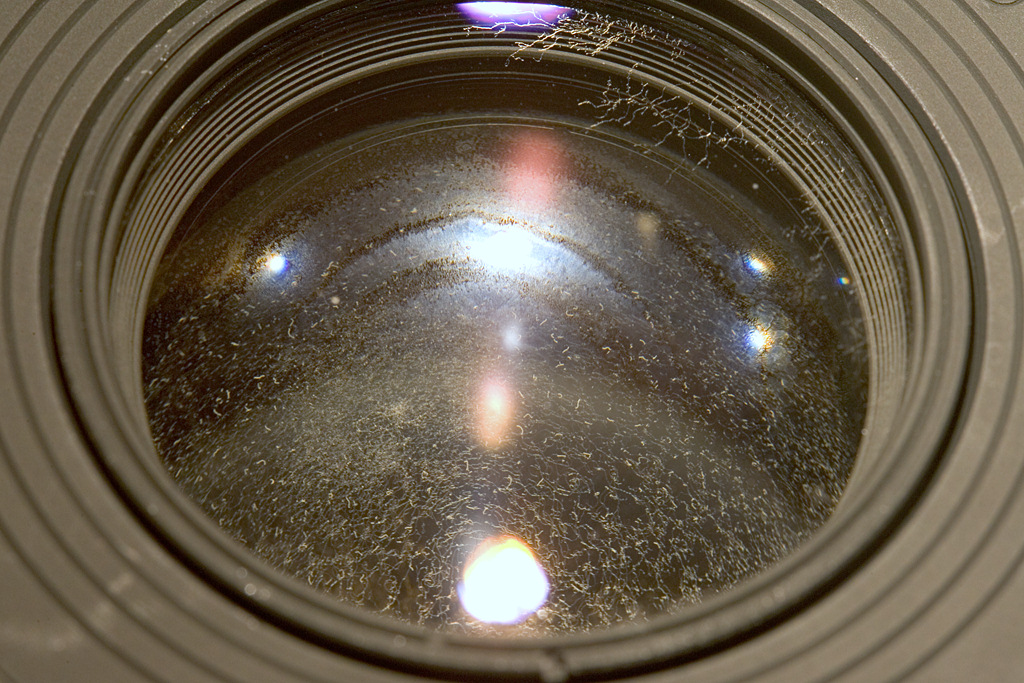

Posted 01/09/2008 03:22AM #3
Think maybe I can save this pristine (as advertised) pup? 8O
SmokeDaddy's attachment for post 119502
