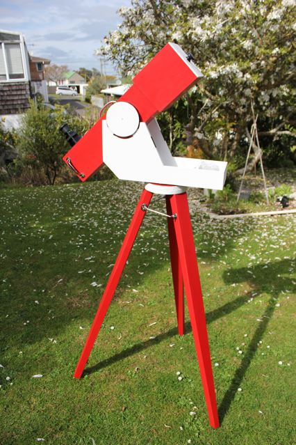

This is a wooden scope made for a niece and nephew as a Christmas present. It has a surplus shed 100/600 lens and a 50 mm elliptical secondary.
It is supposed to be like an Astroscan on legs, hence the red. It is a bit more user friendly than my earlier prototype( a 127/830)
The lens is OK but not spectacular, however in the 20-100 power range it is fine.
Best wishes
Kevin Barker
Kevin Barker's attachment for post 56168

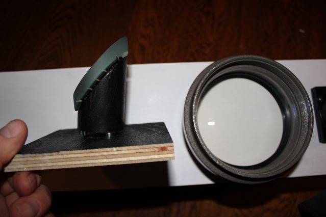

The attached Jpeg shows the secondary arrangement and the objective, note the tooth picks!!!
Kevin Barker's attachment for post 145233

Kevin:
That's a real cutie... Love the Edmunds paint scheme.. 100mm F/6 is a pretty nice place to be for low mags.
Jon
Posted 09/02/2012 02:50AM #3
Thanks Jon
I had some old red oil based paint lying around.
the white is to prevent folks walking into it.
That has happened to me before at a star party
Kevin
Posted 09/02/2012 06:05AM #4
Very nice Kevin, he will have a lot of fun with that. grin
Posted 09/02/2012 10:02PM #5
Great job! The color scheme is nicely done and the handles top and bottom are a nice touch. Perfect for the youngsters. I am sure they will love it.
I also have one of the SS 100m/f6 lenses in a scope. I agree with your assessment. It is very useable but begins to fade quickly at higher powers. A 9mm was about the highest I could ever use.
What's coming next?
dan
