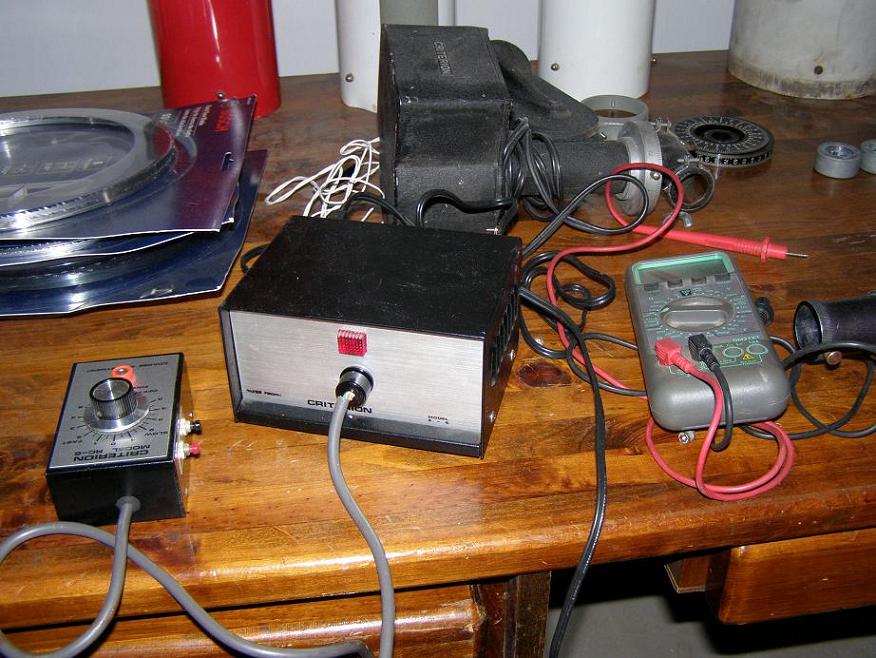

I picked this unit up without any paperwork. The seller let me take it WITHOUT payment till I can check it out.
I floundered around checking it, found no voltage variation, then discovered that it does frequency mods. The output runs about 213V at no load, and about 130 +/- volts with the RV-6 plugged in. Frequency goes from about 56 hertz to 63 hertz when plugged into the wall. I never did get any reading out of the 12V plug. I then forgot to get back to the seller for about 5 days and just recieved an inquiry. I'm a space
I really need specs and a copy of the full directions to correctly check this.
help,
Neil

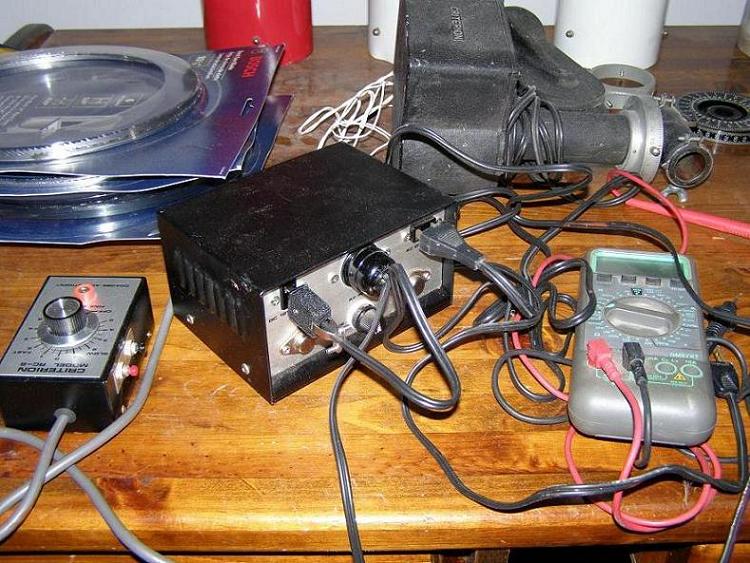

Here's the back.
help,
Neil
The knob on the HC allows you to vary the driver corrector's frequency. That changes the speed of a synchronous motor, an AC motor, which is what this was designed for.
