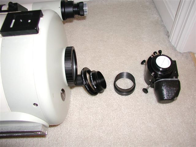

Here's what I did for my Mewlon 210:
Alpine Astro (Astromart Sponsor) has a M71-72 adapter that is advertised for the Mewlon 300, but it fits the 210 as well.
Borg has a 7912 adapter that adapts the Takahashi M72 threads to work with Borg components.
Borg has another component that fits into the 7912 and exposes SCT threads.
Put them all togehter, and you can use any SCT accessory (including external SCT focusers!).
Attached is a picture showing the exploded parts leading up to a JMI NGF-S focuser that has seen duty on SCT's, refractors and now this Mewlon thanks to the various adapters I've found.
HTH,
Eric
