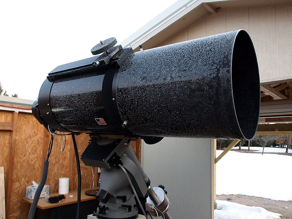

Posted 11/29/2008 01:09PM #2
I have a 1992 C11 that I use for imaging and I can attest to value of a CF tube. Here in MN the temp can and does drop rapidly over the course of the night. With the original aluminum tube, it almost always required refocusing after about one to two hours. I decided to replace the tube with one of Franks's (Public Missiles) CF tubes. What a difference! In the year and a half since I have had it, I have never once needed to refocus during an imaging run (now perfectionists may disagree but it is tough to tell the difference in star size from the first image to one taken three hours later). I usually image at f/12 (3370mm) with this setup. My two cents worth.
Chris
Cedar, MN
Chris1's attachment for post 126585
