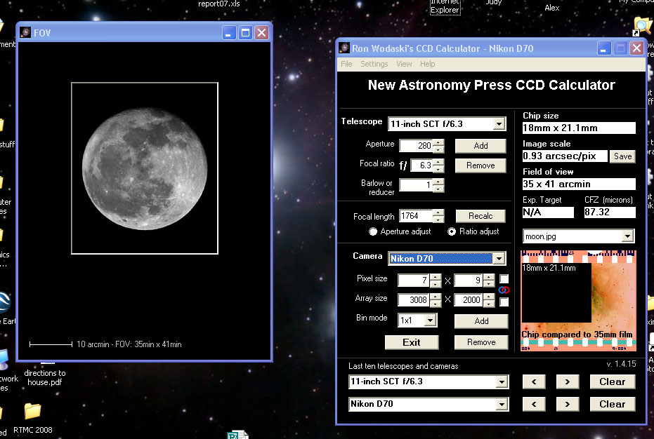

Here's a screenprint of Ron Wodaski's ccd calculator using an 11 inch F6.3, with a D70. You might enjoy going to Ron's website for a free download and then playing with your different combinations of scopes, cameras, and images for your own edification.
Alex
Alex McConahay's attachment for post 119920
