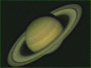

Attached is a stack of 250 hand selected images (reduced 50% of the original 640x480 image) taken around 11pm EST on 3-27-06 through the Astronomical Society of Harrisburg's 17inch Cassegrain at Naylor Observatory, Lewisberry, PA.
The CSC was calling for average seeing and transparency through about 10pm that night or I wouldn't have even attempted to do any imaging.
I started capturing AVIs around 9:30 at prime focus (F15, 6477mm f/l) with mixed results. Near the end of the evening I decided to insert an Orion Shorty Plus 2x barlow into the optical path to try to increase image scale (although I knew it was exceeding the diffraction limit at almost a 13,000mm f/l). Saturn was so large at this f/l I had to rotate the Toucam in the focuser so it would fit totally inside the 640x480 frame. I also had to constantly adjust the RA/DEC on the drive to keep it from moving off the frame. At the time this AVI was captured I looked through the shutter on the dome and could barely see Saturn visually, the transparency had degraded to 1/5.
The resulting image is a bit noisy and you can see a dust mote on the lower section of the Cassini division, however I was surprised how good this turned out given the average seeing and 1/5 transparency.
Comments/suggestions welcome.

Nice shot Weiman! 8)
I played a lil' bit in Photoshop with it... hope you like it... wink
Keep it up! 8)

Very nice Weiman. I hope you get a chance to use the scope again on Saturn.

Great to read your report and see the image through this big cassegrain. You might consider using eyepiece rather than barlow projection to have greater adjustment of the image scale. Somewhere between the two is probably best in average seeing. This image is probably over sampled for the seeing and it looks like the poor transparancy left the image a little starved for signal. But it is nice nonetheless.
I hope you have a chance to try again and share the results.
