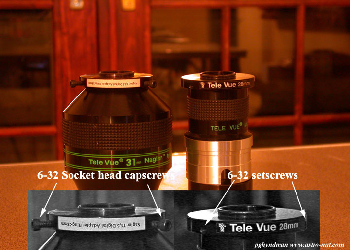

Here ya' go Dave... direct from the Digital Astro egroup's FAQs page:
http://www.szykman.com/Astro/Adapters.html
The FAQs themselves can be found at:
http://www.szykman.com/Astro/AstroDigiCamFAQ.html
If you have removable rubber eyeguards on the EPs you'll be using, chances are you can use the 28mm TeleVue adapter as listed here, though you may need longer 6/32 capscrews if your EPs are smallish in diameter:
http://www.buytelescopes.com/product.asp?t=&pid=3373&m=3
and installed as shown below.
These provide secure, close mounting so as to minimize vignetting AND chances of an "Oooops!"
Paul

Posted 04/17/2003 02:28PM
#2
I'm not sure about Televue adapters, but from Paul's photo it appears that they work like the Takahashi adapter I use which is in two parts. One ring bolts to the eyepiece and the other screws into the filter threads of the camera lens. There are three set screws on the cmeralens part of the adapter which then bolt the camera/adapter part to the eyepiece/adapter part. This eliminates the need to use the LCD screen for focusing. First focus the eyepiece without the camera in place, then bolt it on with the camrea set at infinity and you're all set. Hope this helps and isn't too tediuosly obvious.
