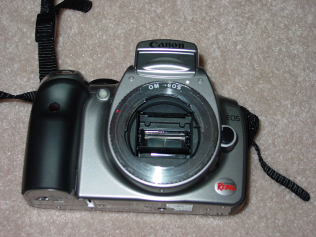

Tell me about this adapter. What is it? Where did you get it? How does it work?

alex, i have put a picture of the adapter. basically it is a machined metal adapter that you attach to the camera and then you can put any om style lens on. the olympus lens have enough backfocus to allow you to get to infinity at least with the lens i have tried so far. i have a few om lens so it made sense for me to give it a shot. i purchased it from a guy in hong kong. if you want you can email me and i can give you more info.
