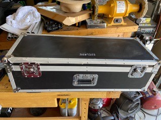

Ken - I have a pair of Explore Scientific scopes, an 80mm and a 127mm, that was my primary imaging rig until I went Tak. I'm in Valley Center and would love to find a buyer for both that's local. $3000 for both. PM me if interested.
