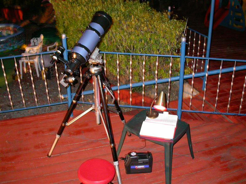

Hi Paulo,
For large dim objects, they are great. I have reasonably dark skies, and low power wide field views of the Milky Way are very nice. Small planetaries that require high magnification will not work out as well, as these type of short refractors tend to not hold up to high power views. I use a 31mm Nagler with mine, but it taxes the focuser a bit.
Here's my initial review:
http://www.astromart.com/forums/viewpost.asp?forum_post_id=231758&poll_id=&news_id=&page=

David Simons's attachment for post 110717
