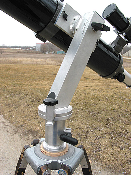

I am not familiar with the C-8 never having owned one, but I had a refractor on an early Unistar. My holes were not threaded, so I could simply remove the dovetail from the rings and bolt through the plate into the rings.
If your configuration is different, I have used a good hardwood like Maple to make adapters to mate scopes and mounts to good effect. Much easier than working metal and very hard and strong
rnabholz's attachment for post 94783
