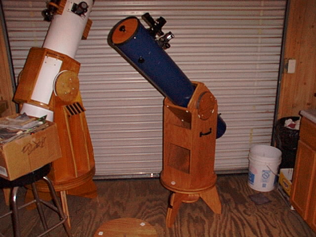

This is a Stargazer Steve 6" Tube that I built a new mount and modified the tube. The scope has 2 bases, one for standing up, the other for sitting down. I took out the massive 5 lb counterwieght in the back, moved the mirror down as far as I could, moved the focuser back, put the rigel finder on top of the old focuser hole, added a 6x30 finder, scope works well.

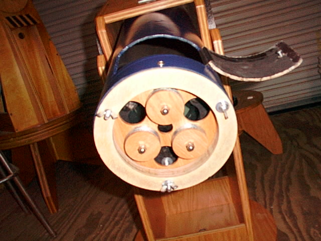

Posted 01/25/2004 06:37PM #1
New mirror cell, I routed out the old backing plate, took out the massive counterwieght, installed a new backling plate with ventilation holes, and 3 smaller 8oz weights. I justed used 2"x1/4" fender washers as the weights since they weigh about 1oz each and are only .25Cents each. Each weight pack has a 2" wood cover and a cap nut to hold the weights on. Can easily add or subtract the weights as needed.
