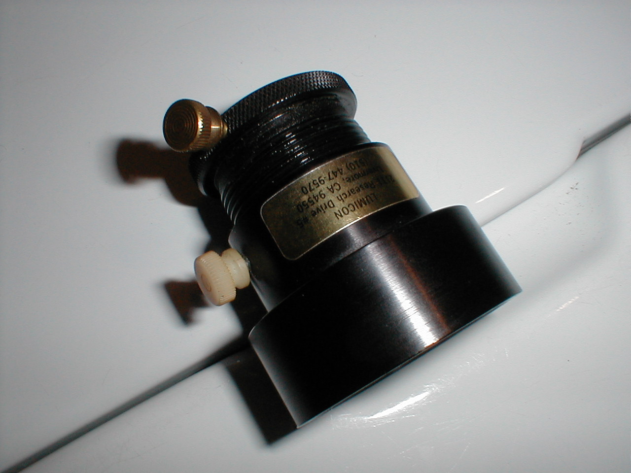

I am assuming that you have the old push-pull pvc focuser thats glued into the tube. Thats what my Odyssey 10 inch had. What I did was to buy a helical adapter from Lumicon thats screws on to the fitting thats attached to the tube. Just unscrew the old pvc pipe fitting and screw this one on. I've replaced it with a JMI reverse crayford the other day and still have the Lumicon adapter that I was going to put up here on AM, but if you are interested, drop me a line.
Roger
rhinson11's attachment for post 95255
