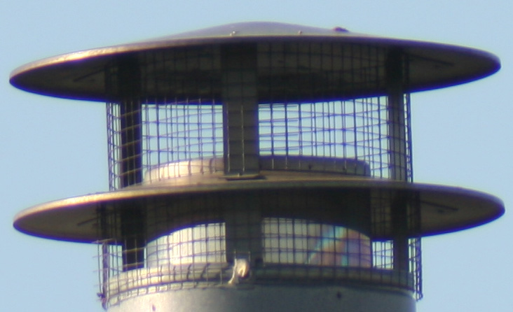

Hi,
I am sharing two pics with anyone who is intersted in the WO APOGRADE for their scope. I am writing a formal review, but wanted people to see for themselves what the differences are.
Let me know what you think of these two comparison shots.
Thanks,
Timm
Posted 03/14/2006 09:32PM #1
Shot prime focus with a Canon 20D, cropped to 100% view. The shot is in focus, and the Semi-Apo lens is collimated perfectly by me.
Timm

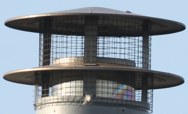

Posted 03/14/2006 09:34PM #2
Same picture but with the FD lens, collimation has not been touched, this is how it came from WO, I had to move the tripod back about 10 feet, so that the magnification would be roughly the same. Again cropped to 100%.
Timm
