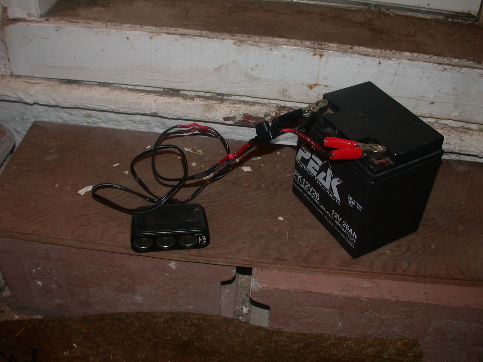

As an sct guy dew straps come naturally to me and it is much easier to keep my 4" and my 5" refractors dew-free than my 14" SCT. All you need is a power supply that's up to the job. I'm including a picture of my simple but works power supply; note that I installed an in-line fuse in the cord. But this is more than enough for a four inch refractor dew strap.
Greg N
gnowell's attachment for post 129021
