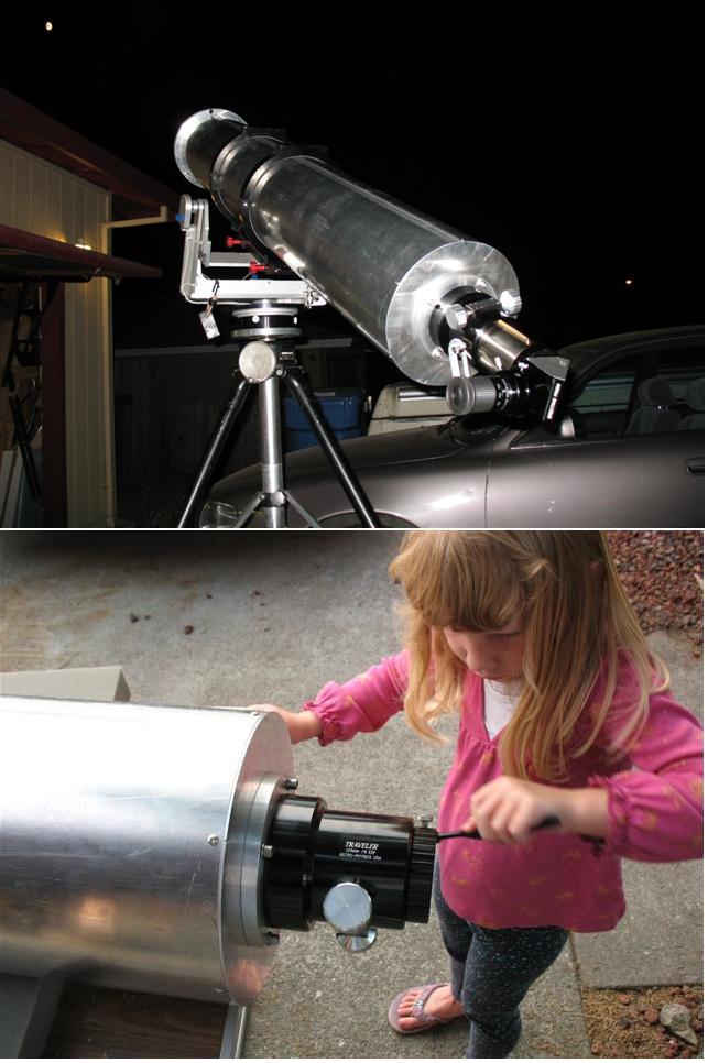

I am getting close to finishing my 8" f10 achromat OTA (Ukraine Lense) with first light this last weekend. Lots more to do, baffling. flocking, choosing paint color etc. I designed the lense mounting cell to be removable from the OTA end plate flange. I have captive thumbscrews on the tube flange, and guide pins on the lense cell so re-mounting is repeatable. For transport the lense and focuser are removed, with the empty tube length less than 5.5ft long, and ~20 lbs, fairly easy to manage. However fully assembled the tube is at 6 feet, and shy of 50 lbs which makes for somewhat of a beast. (note: Blonde assistant also wanted to help clean the lense)
As you know, the needle sharp pinpoint stars are breathtaking.
Finally saw the three larger craterlets in Plato without much trying.
Jupiter was still boiling being low on the horizon, but the mottled subtle detail on the polar regions was very satisfying. (Pentax SMC 9mm)
I also have a short tube 8" f6 doublet which gives beautiful wide field views. The Veil, Double Cluster, dark nebula, Milky Way, Virgo Galaxy clusters, and of course Sagittarius region all are awesome targets.
