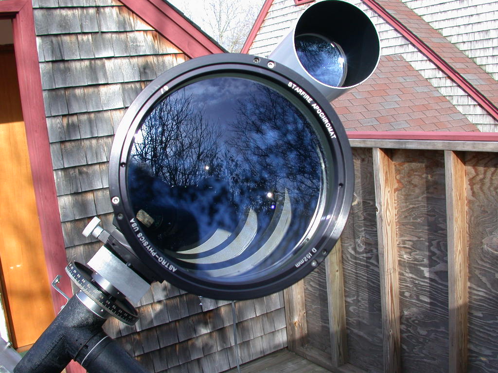

Posted 03/27/2004 09:54AM #2
Dave, I've had this baby since 1991. No spurious color that I can detect at 50+ power per inch and no oil leak issues. Dom Q.
daqua's attachment for post 77941
