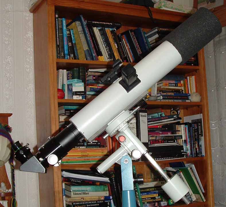

I think I can answer this question. I have owned a D&G an 6 inch f -12. And currently own a Zeiss APQ 130 an f 7.7 triplet apochromat like the AP.
While the D&G will have excellent smooth optics and a lovely star test the amount of residual chromatic aberration for a 5 inch at f 10 will mean low contrast markings will be harder to see in this scope compared to an apo. The AP will reveal sharper more well defined planetary images.
It will still do a tremendous job but in terms of image contrast on fine planetary detail it will be slightly less impressive than an AP 130.
My brother has recently sold his 5 inch f 15 D&G after acquiring a 715 Maksutov. His scope was fairly close to the point where secondary colour does not hurt the fine detail to the extent of a shorter focus achromat.
I have recently built an AS 80 f 10.5 short flint achromat of a high quality which has significantly less false colour than a standard achromat. It is effectively like an f -15 3.1 inch achromat. I have tested it beside an ED doublet (semi)apochromat and it holds up well, possibly being better at rendering fine detail on planets than an ED. Using this as an example and knowing how good D&G achromats are I would say an f 20 or 25 D&G 5 inch doublet would approach the apo performance in terms of planetary detail seen at the eyepiece. In short if you get to a focal length 4 -5 times the aperture in inches false colour starts to be barely visible and a non issue with respect to performance.
Deep sky and double performance would match an apo at f 15 with a 5 inch D&G, possibly f-12.
5 inch D&G's are excellent and vastly superior to the average short focus Chinese mass produced scopes. They are a much better value at less than 1500 US in an ota than the $5000 or so for an AP.
One last point, I am convinced long focus doublet achromat's have the potential to approach or even out perform short focus triplet apo's for visual use. A bit like the argument for planetary eyepieces and how monocentrics and orthoscopics seem to be the best. Less glass and potentially superior polish etc.
Best wishes
Kevin
Kevin Barker's attachment for post 77495
