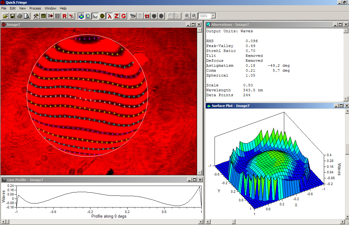

Posted 02/26/2009 08:10PM #2
Here is what a 130mmF6 triplet apo looks like when the elements are first assembled after grinding, edging and polishing, but before hand figuring and careful optical alignment.
Rolando
