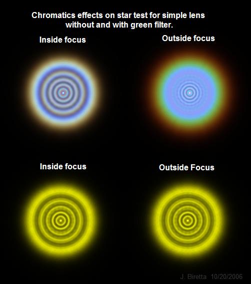

Some of it could be chromatic effects. It is best to do
these tests with a green filter. The attached image
is not for an AR5, but will illustrate the general effects.
This is for a "perfect" lens that has only chromatic aberration.
No spherical; no turn-edge.
m87's attachment for post 108337
