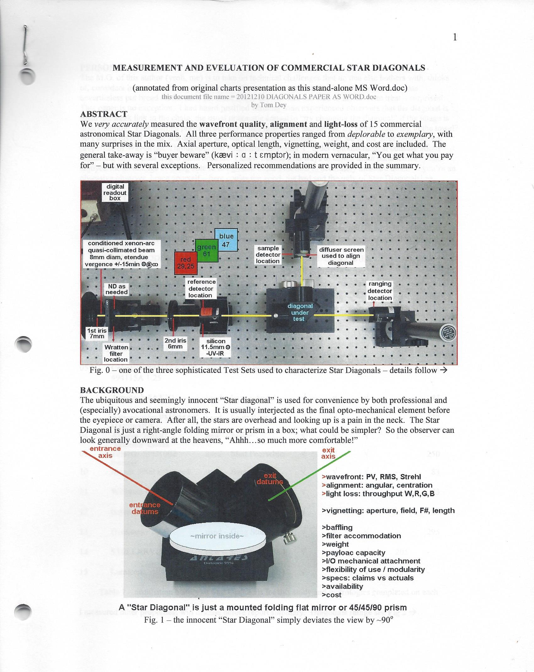

Posted 09/09/2015 03:34AM #1

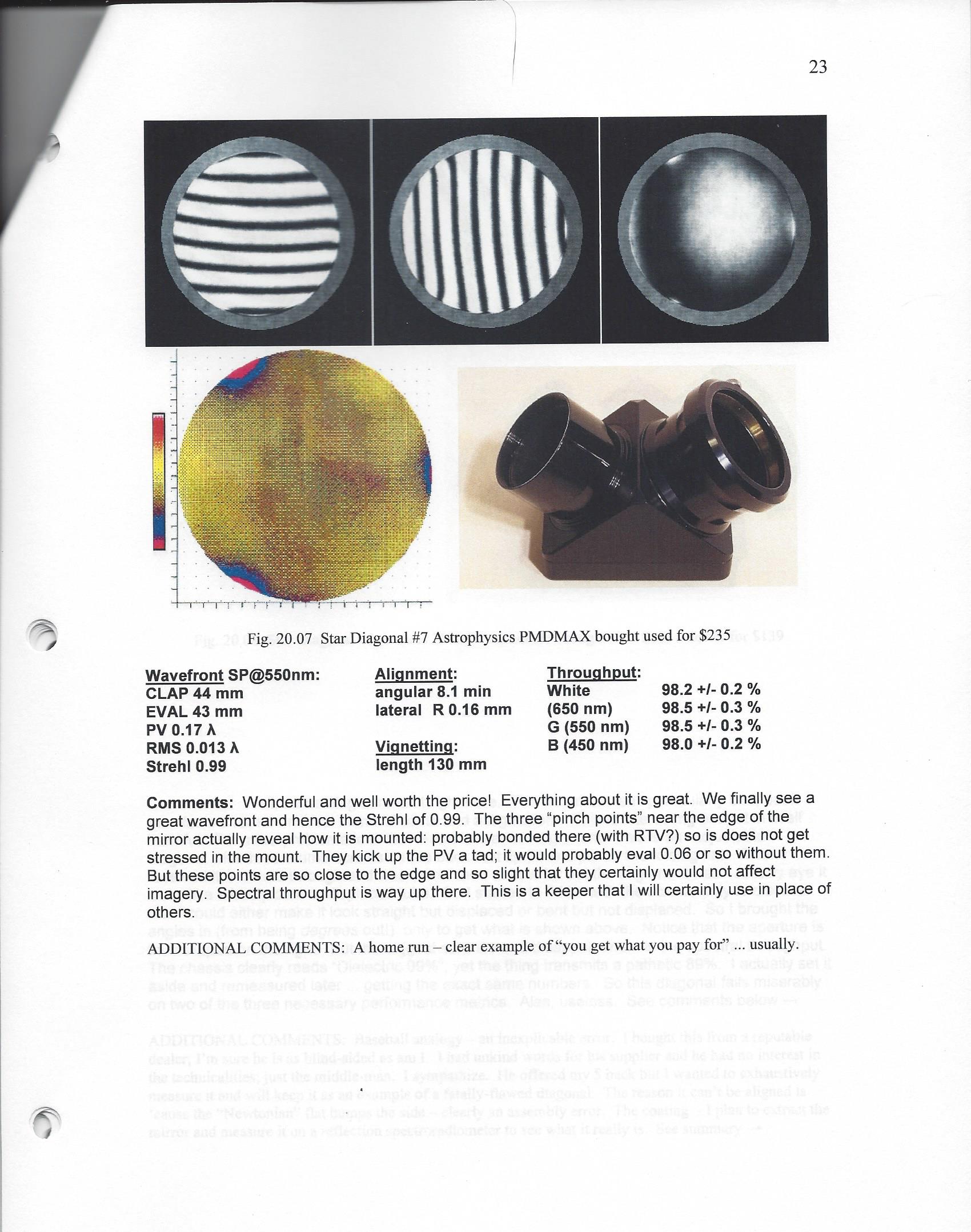

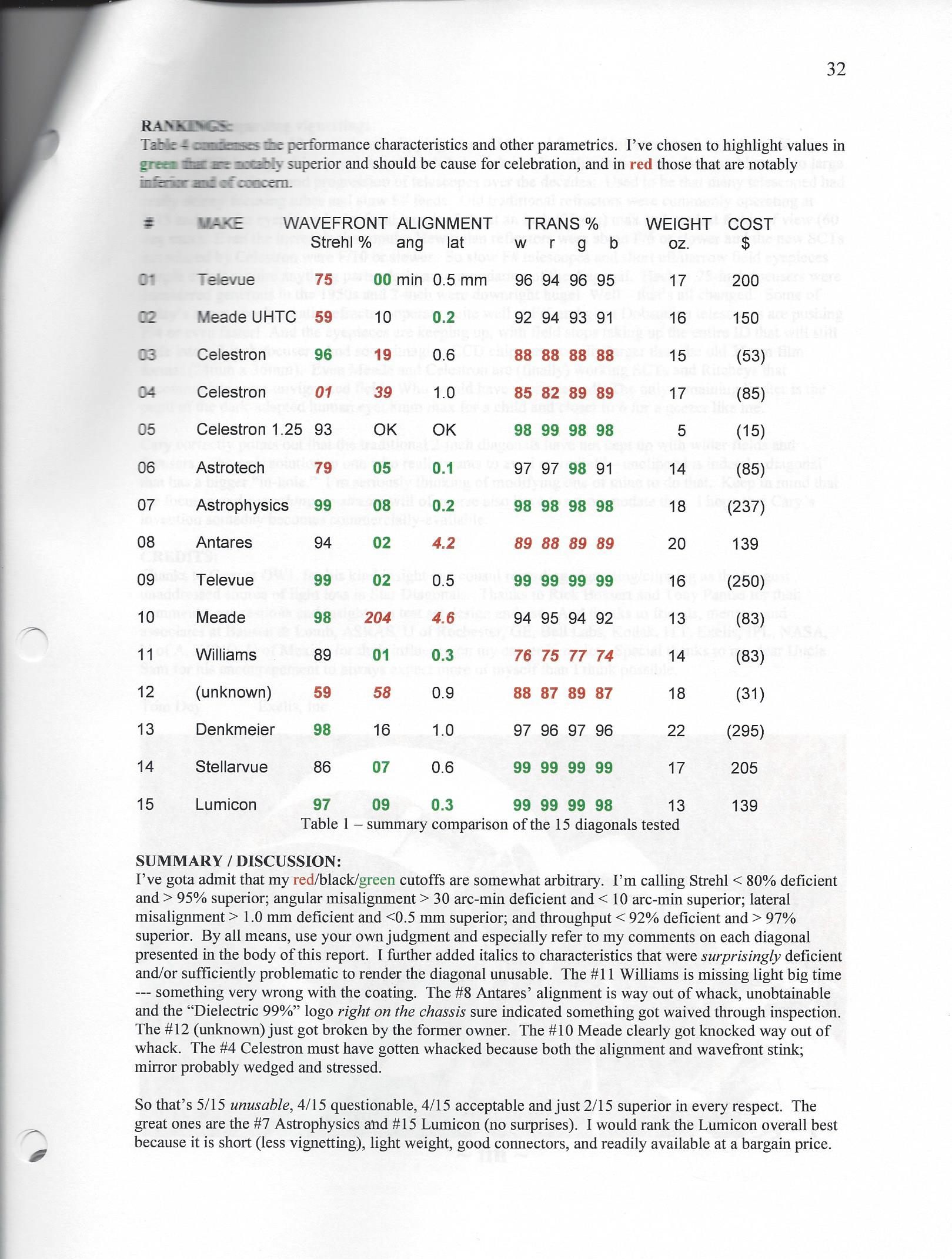

Hi Greg! Your post piqued my interest because I live nearby (Springwater, NY), am interested in getting a good refractor, into physiological optics and researched 15 Star Diagonals - including your make and model! Here are (images of) 3 pages from the report, including page 23 that gives the results for the AP MaxBright...superb. But I would indeed suspect that any diag that gets disassembled and put back together back can indeed risk stressing of the mirror...which usually results in (severe) astig. Anyway - here are the 3 pages. I can send you the whole thing on a CD or DVD. My papers tend to be big files because the images are usually high-res. To any readers: I've got dozens/scores of informal papers like this e.g., but they tend to be lengthy and technical so I haven't submitted to the ATM/avocational Astronomy community. Tom Dey (Thomas Dey)

Posted 09/09/2015 03:35AM #2
page 23
Thomas Dey's attachment for post 149985

Posted 09/09/2015 03:36AM #3
page 32
Thomas Dey's attachment for post 149986
