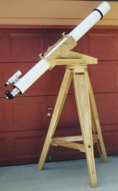

Mounting is *definitely* an important consideration. Most of the D&Gs I tried utilized alt-az mounts similar to this one (attached .jpg -- courtesy Dale Keller).
Best wishes.
-Dan
DrThud's attachment for post 77144

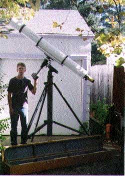

well this is my baby 6-f/12 d&g, it don't get no better. john
frogs's attachment for post 77801

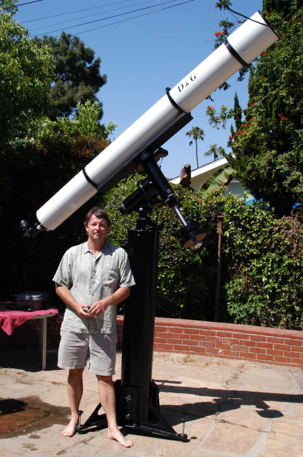

About those mounting requirements for long focal length refractors....
(D&G 8" F/12, Parallax HD150 on a 60" tall pier)
lthaxton's attachment for post 79969
