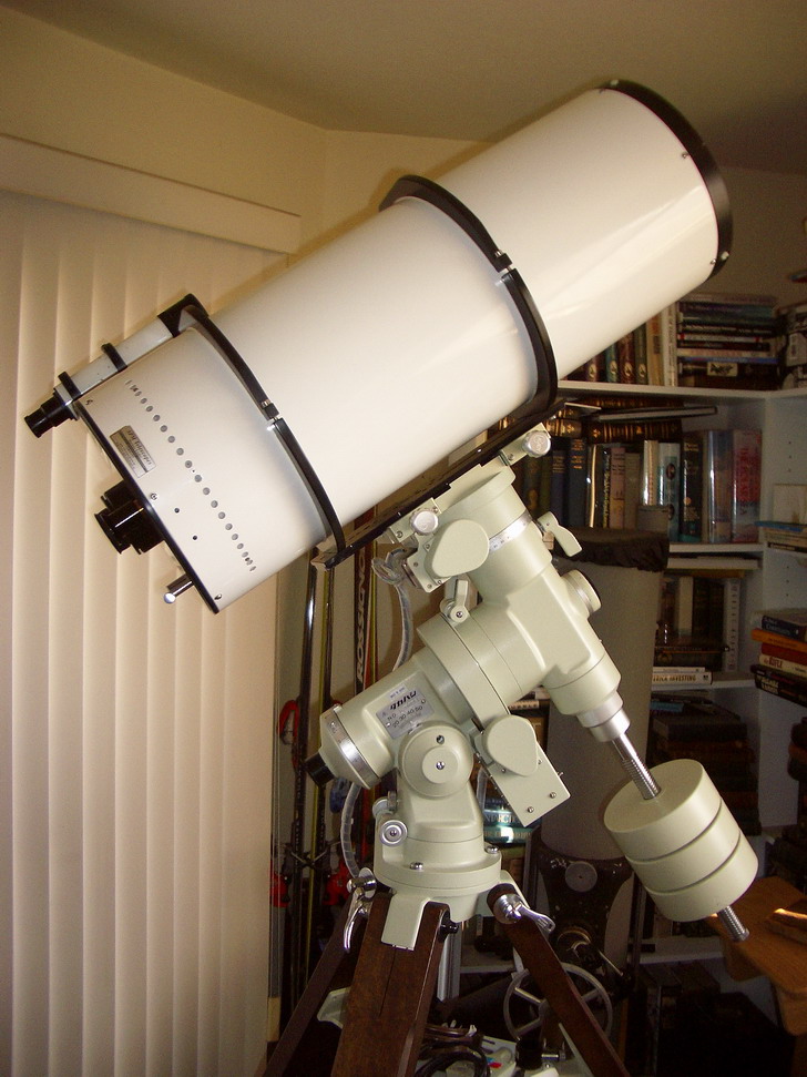

Not a direct answer, but I went from a 6" F/15 D&G to an 8" F/12 D&G and did not find the color in the larger scope to be any problem. I did not have them side by side to compare, but the color in the 8" was just a bit more pronounced than the 6". Much less than I expected. A fellow out here added a Chromacor to his 8" D&G and never looked back. He said the 8" gave views similar in detail to a 16" Newtonian he owned.
I still envy your observatory. By the way, I went from the 8" D&G to a 10" Mak-Cass.
lthaxton's attachment for post 109736
