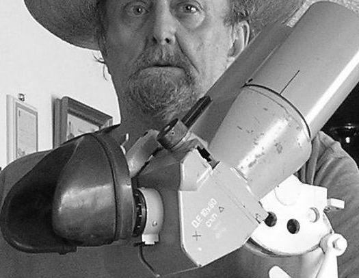

I also love the wide field views. My choice is a pair of WWII German 10x80 flak binoculars.
I have them mounted on the original steel tripod & they give wonderful views. They were made primarily by the companies--Moeller, Leitz, & Busch.
My pair was made by Busch & with the giant prisms & big Erfle eyepieces they have a FOV of 7 degrees 32'. It really does almost take your breath away.
I bought mine in May of 2002 from Charlie Orzech of NC.(Hi Charlie). You can find them fairly easy for $700-$800 I think. I got mine on Astromart. Also, Texas Nautical Repair in Houston (Takahashi) has a reconditioning & repair service for them.
If you have ever looked through a pair of the big 10x80's you wont forget it!
I would really like to hear from others about their experiences using them for wide field viewing.smile
