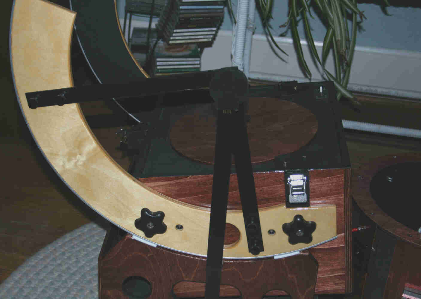

Hello,
I have a new atm dob with 40" diameter oversized altitude bearings--something like the new 18" Obsession's altitude bearings but larger. Eventually I would like to mount optical encoders. No real center to mount to and direct rolling off the altitude bearing results in a great many turns of the encoder for even small real altitude movement. Any ideas?
Thanks,
Daniel
Posted 01/01/2008 10:48PM | Edited 01/01/2008 10:50PM #1
Hi Daniel,
I had a similar issue with an ATM 10". This is the solution we came up with for mounting the altitude encoder. The pivot center ended up being up quite a ways! Is this what you are talking about?
(Apologies for the pixelated photo - I reduced it considerably for posting purposes!)
swsands's attachment for post 119327
