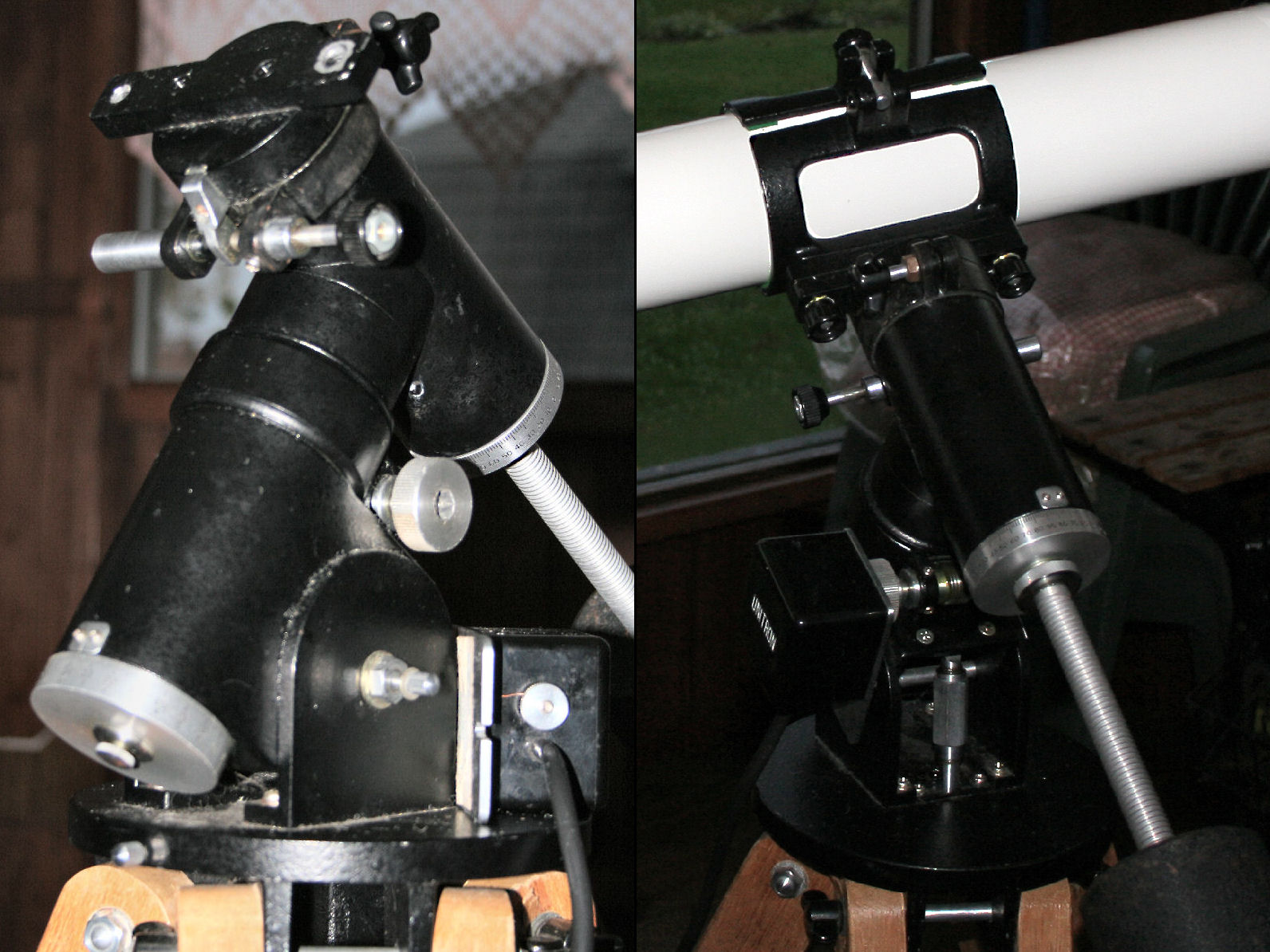

Posted 05/19/2009 09:38PM #2
It may be so that you could consider an old Unitron mount. Those are very reliabla and can take a lot more weight than told in the specifications.
I have for instance this old Polarex 803 mount (Unitron was also marketed with the name Polarex in Europe) and it can easily take my 8" Schmidt-Newton with 2.4" guide scope and DSLR camera for photography. OK, I have a frequency corrector for the motor drive but thats needed for photography, not visual.
It's a lightweight mount as might be seen in the picture attached.
Regards
Jonas
