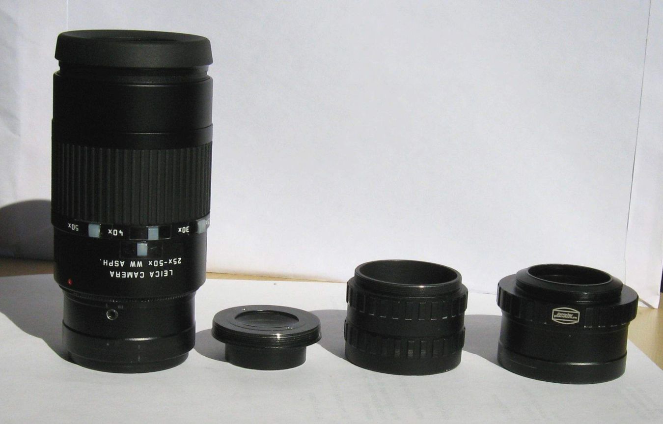

The attached picture gives an impression. From left: Zoom with 2"-barrel, barlow lens for 1.5x, 30mm T2-extension for 2x, 32mm T2-extension for 2.5x. The two combos 1.5x and 2x fit within the 2" eyepiece holder of my Baader Maxbright diagonal, the second extension will be placed outside the eyepiece holder. The white markings on the eyepiece body are little pieces cut from a nylon cable binder and glued onto small strips of transparent selfadhesive tape. They enable "feeling" the chosen magnification and are placed such that they give with my TEC140 mags of 60x, 80x, and 100x unbarlowed and the corresponding magnifications multiplied with the barlow factors.
