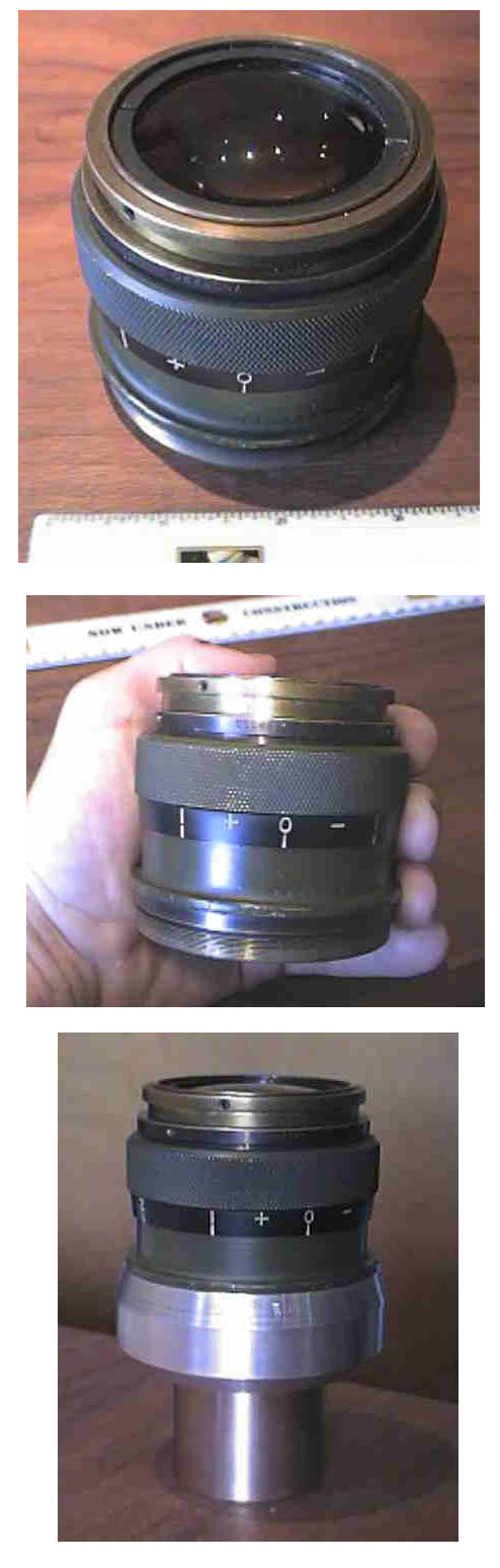

As part of another thread, the topic of radioactive war surplus optics, in particular eyepieces, came up. When I first heard this, I thought yeah, right, another urban legend. But I happened to have a huge old Erfle that apparently came off an M4 Sherman tank, and had just spent a lot of time making a wunnerful adapter to put it in 2" eyepiece tubes, when I heard that. So I had it checked out by a local hospital radiology department (after trying two fire stations and learning that one didn't have a clue and the other had thrown away its Geiger counters -- so much for the "security theater" of emergency preparedness, foreign nasties with dirty b--bs, etc). Sure enough, it was "hot" enough that one wouldn't want to put an eyeball behind it for any length of time. Like, when spending hours staring at deep sky objects. Now, just because it puts out alpha particles doesn't mean it's completly off limits. Alpha is easy enough to stop; a simple glass cover window would do it. But in this case, I gave up when I realized that the glass itself had turned brown from radiation damage, and my original idea of recementing the elements wouldn't fix that. A pity, because it's a wonderful hunk of glass and brass. For reference, I've again attached my image of this huge thing, with and without the aluminum adapter I made.
Here's a copy of part of a reply posted to a different thread here (under "help identify mystery eyepiece"). I figured this is a different topic and probably important enough to warrant its own thread.

Pete Albrecht's attachment for post 20137
