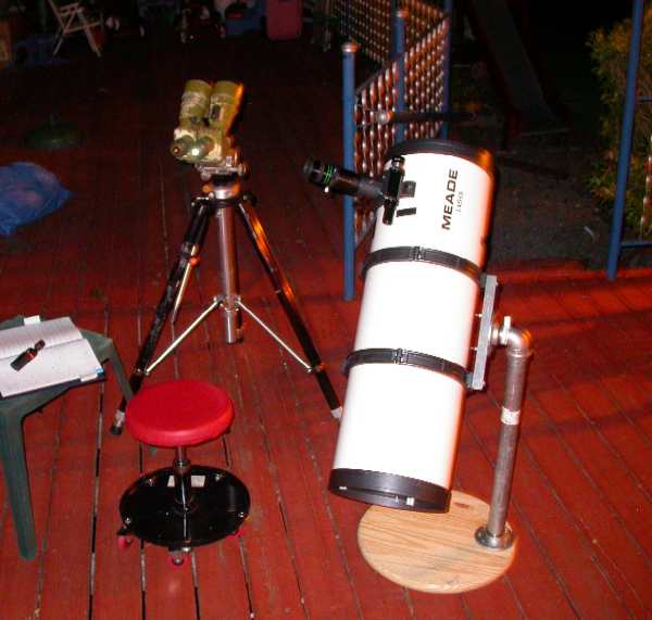

Hi Bart,
I shopped around for a dob conversion of my Meade 10" SN. I got numbers in the range of $400-500.
Yes they were works of art, but I wanted to try out the idea first to see if I like the scope that way.
Last May, I was at RTMC and saw a fellow with an old style pipe mount (he later won a merit award), and I was inspired. So I visited the hardware store, and spent $39, and in literally one hours time I had this mount. OK it looks it too smile but with a second iteration, + paint, and a rotating base with teflon etc., it should work very well. I am able to use the scope quite easily even with the small base.
The tools needed to build this mount, are a drill and screwdriver.
Sincerely,
David Simons
PS. The military aircraft spotting bino's and this wide field scope are a wonderful combination.
David Simons's attachment for post 82148
David Simons
