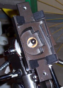

I have an older Vixen GP and would like to use a dovetail on the mount. Below is a photo; what part would I need in order to accomodate the dovetail and where might I obtain it?
Thanks--this is my first GEM and I'm leaning about it as I go.

Ken's Rings came through with a very elegant solution. Thanks, Ken!
Don

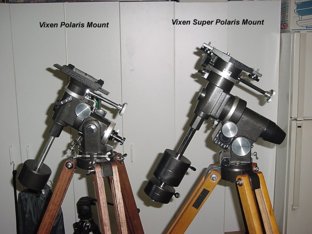

The mount shown in the photo is NOT a Great Polaris (GP) or Super Polaris (SP) mount. It is the Vixen Polaris mount. The saddle is very different between the two. There is a significant difference between the two. No only in the casting itself, but in the hole spacing. I am attaching a photo that shows the Polaris and Super Polaris mount. Someone could fabricate a dovetail to attach to the mount, but you would want to be sure they are making it for the correct mount. Since the Polaris mount has a cradle built into the saddle, any dovetail adapter would have to be taller to allow for clearance for the dovetail.
Hope that helps some,
John
jcboyd's attachment for post 76242
