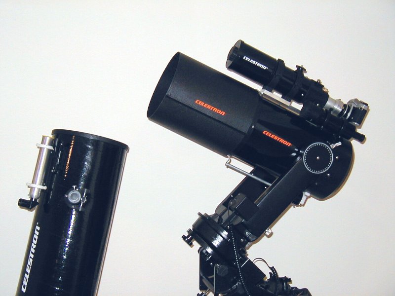

Although the Megarez is probably a little heavier than my ST80 F5 it should work. You will definitely need to get a counter-weight system on the bottom side because this becomes a must have.
Robert W.
raw265's attachment for post 62284
