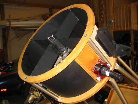

I have a single-speed Moonlite on my 20" F/4. Looks nice and works great.
jrcrilly's attachment for post 83394
