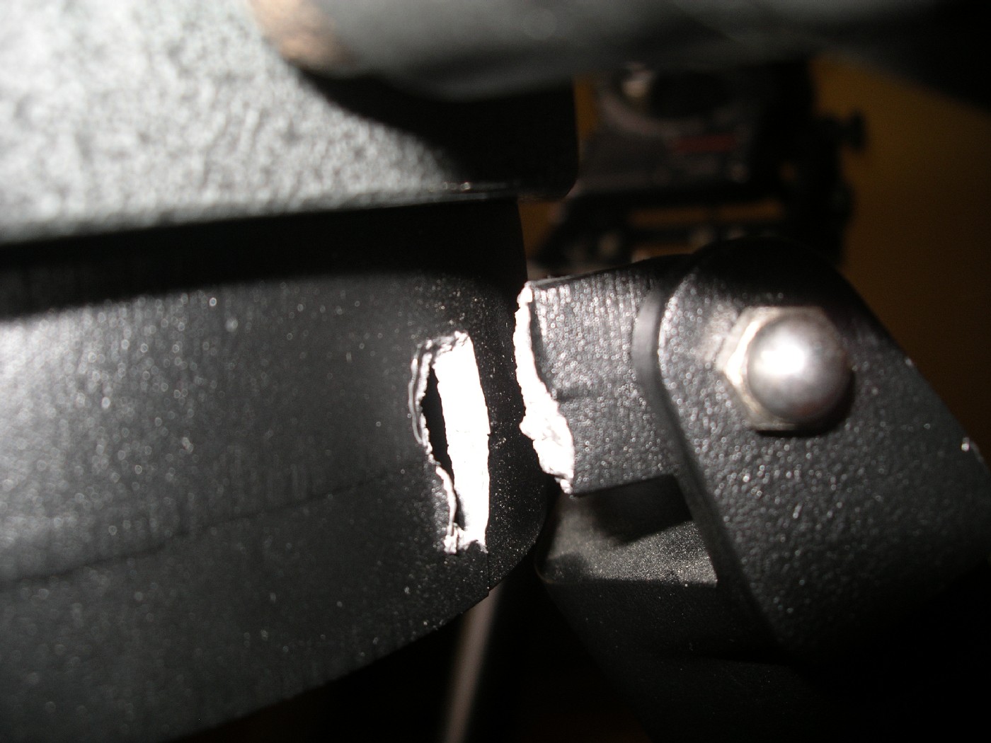

The mount sits on a Meade field tripod and that is where the problem occurred. As can be seen in the photo the cast iron leg hinge broke. I did not drop or band the leg it just broke.
I e-mailed a photo of the damage to Joe and he forwarded it to Meade in California. They were surprised by the damage and thought it might have been due to a fault during casting. They had not seen a defect like it before.
I had to disassemble the tripod head and send it to Joe in Long Island from Toronto. Meade sent a new tripod head from California and it was repaired and sent back to me.
Joe quickly and professionally dealt with the problem and my mount is now back and functioning.
