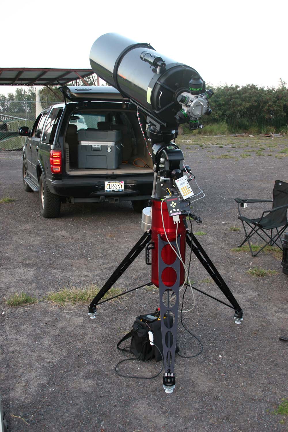

Posted 04/09/2006 07:49AM | Edited 04/09/2006 07:54AM #4
I have been using the Van Slyke Hexagonal 2" Turret on my C-14 and cannot imagine life without it. Have it loaded with type 4/5/6 Naglers...not having to fumble around in the dark to find and insert ep'S during public star parties makes toggling between magnifications a real joy...obviously being on a GEM helps as it allows me to slide the OTA forward to offset the Turret mass. I have both the Astro-physics Maxbright diagonal and turret and there is no apparent difference in visual performance...the other thing about the Van Slyke is that it has an integrated filter slot adapter so that a filter can be inserted and shared out very easily to all the Eyepieces...not having to remove the EP's means less contamination of the diagonal as well...I say go for it...
