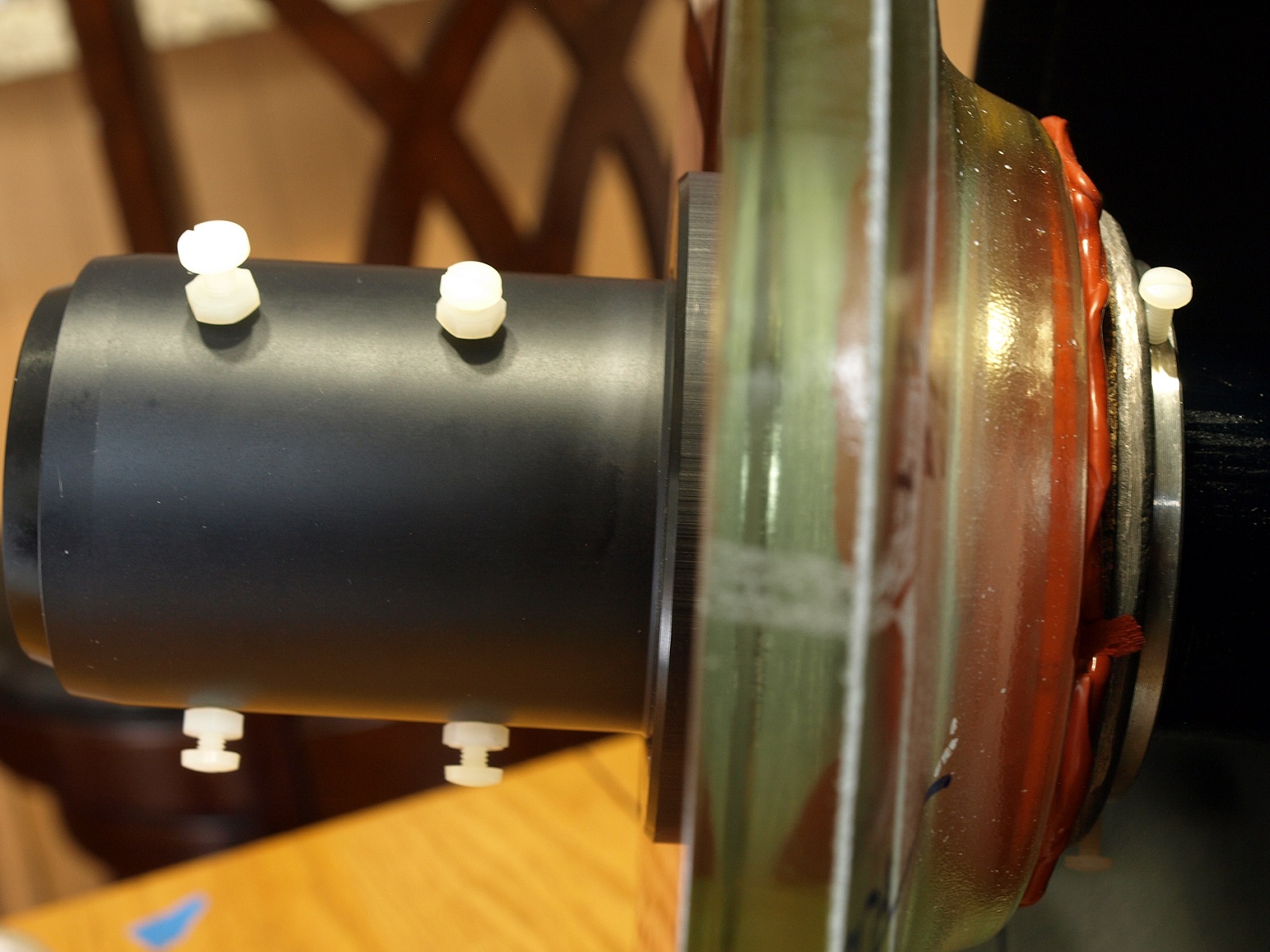

So after fighting with this for the past couple years, I decided enough is enough. I know the optics are capable of taking excellent images so I was convinced it was not the optics. And I was not afraid to take things apart. The Celestron SCT's are not that complicated. Reading on forums what other people have done to cure this got me thinking about what might be the best "fix" for me. I am amazed at the ingenuity of contributors to AM and other forums. Seems like it all comes down to the clearance of the mirror support on the support tube attached to the rear cell. So how to take up the clearance? I liked the "fix" by a CN'er that put nylon screws into the mirror support tube to take up the clearance. That "fix" had the nylon screws on the mirror support tube in front of the first surface of the mirror. That was going to be my fix with one twist. I know the mirror assembly is very heavy on the mirror end. So in addition to the screws in the front (I put 4) I put two nylon screws behind the mirror. After tightening the screws, I put a dab of black automotive RTV to secure those two screws since I could not get a nut on those screws due to clearance.
Picture is worth a thousand words. Mirror assembled to rear cell. Screws just finger tight.

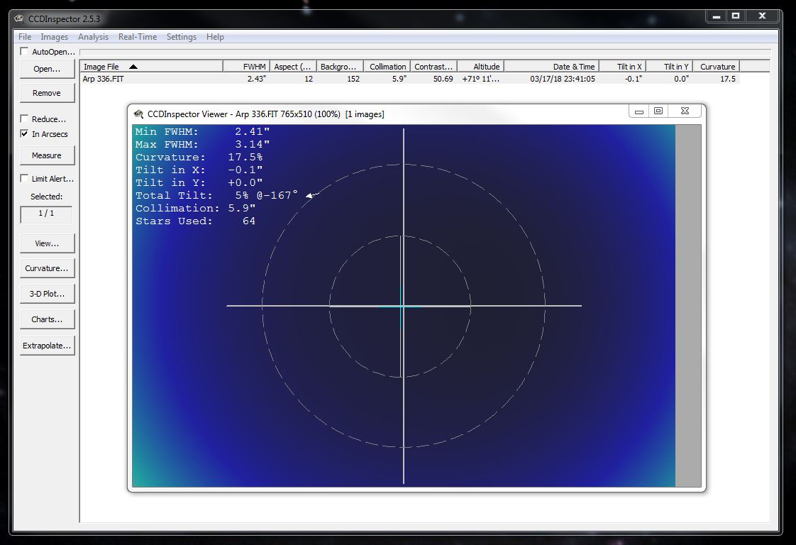

Now for the results. Collimated everything using Hotech and under the stars. I was a little disappointed that my focus shift didn't improve much upon initial testing. But now it was time to image. I picked targets on either side of the meridian and in different directions and did an imaging run. The morning arrived and I opened up the images with some (or a lot of) apprehension. I was pleasantly surprised. No, I was elated! No difference in image quality no matter where the scope was pointed (confirmed with CCD Inspector). I check the FM4 logs to see where the Optec ended up. To my surprise, the Optec did not have to move that much over the course of the night (at first I thought focus had failed and returned to an initial setting but it had not!). I still have focus shift (target moves in the FOV when focusing up to a point) but it would appear that the primary mirror does not shift around on the tube.
Last night I took 18 subs at 10 min each exposure and the Optec only moved 47 steps over the course of the night.
Below is a shot of CCD Inspector. My stars are noticeably "tighter" as was my guide stars.
