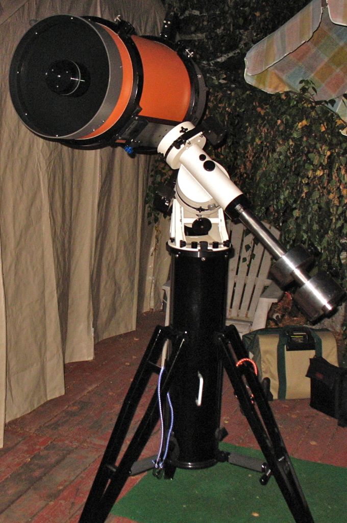

David Simons's attachment for post 142615
