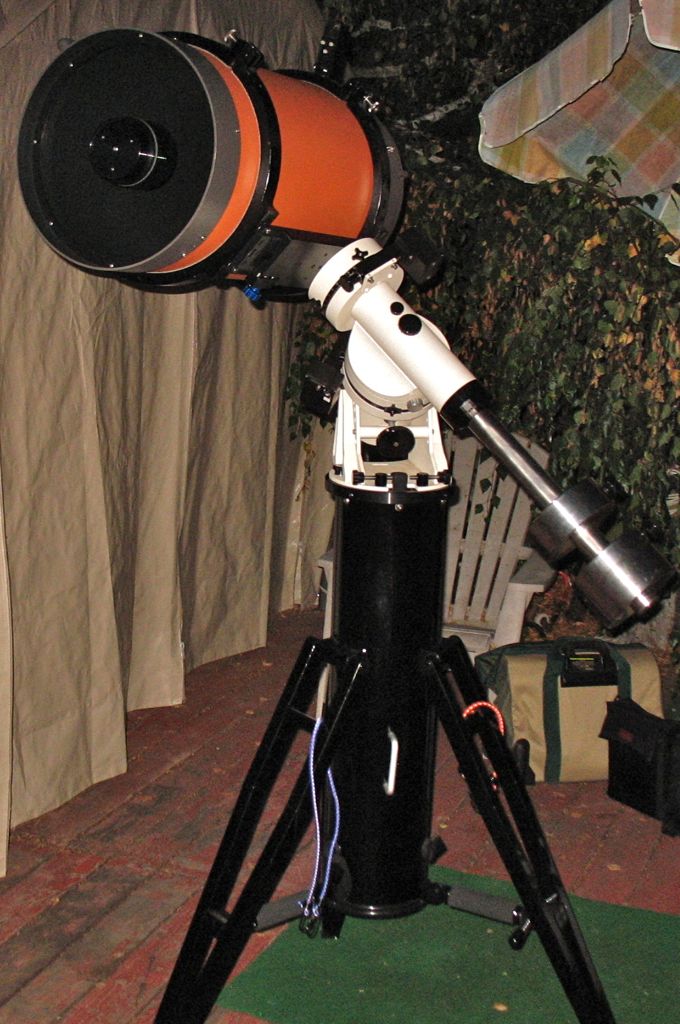

I too have one of the older orange tube C14's, very sharp optics. I can only comment on the Nagler 31 which is one of my favorite ep's with this scope. I do a lot of manual sweeping and star hopping, and I do not recall any obvious visual distortions with this setup. Others may be more clinical.
I am also thinking about the 20 ES 100 and hope others will comment.
