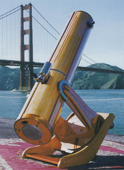

There was an article in the September 1995 issue of Sky and Telescope about one made by Philip Alotis of San Francisco, CA. It was a 12.5" F 7 newtonian on a "convertible" dob mount. He used an automotive front wheel hub and brake assembly for the RA/ azimuth axis. Among the other novel features was a magnetic finder base used so that there wouldn't be any marks on the beautifully finished wood tube. I have attached a picture of it.
Joplin Motisher-Chittenden's attachment for post 62248
