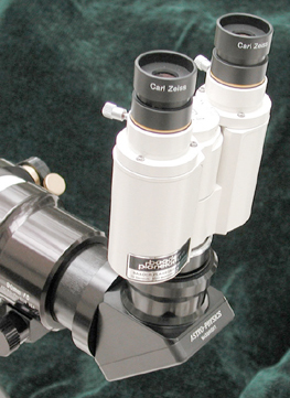

I've been using Siebert Black Night binoviewers with my AT1010 for a few days, mainly lunar and terrestrial so far. I bought these binos partly because they are a little lighter than most others, to minimise balance issues. These binos need the 1.8x OCA to reach focus in the AT1010 but otherwise they work fine in this scope optically. No problem merging images, no obvious chromatic effects, detail on lunar surface is still as sharp as you would expect with the Stellarvue. Especially with a 2" diagonal, balance on a camera/video-type tripod is an issue when the scope is tilted up over 20* or so, so I'm getting an adapter bar made to shift the centre of balance to compensate. The 2" diagonal gives a more secure hold for the binos than a 1.25".
Ian Gibbs

I've been using a recent model of Lomo binoviewers in both a Pronto and a TV85 and have had a really wonderful time with lunar and planetary viewing. I've become very interested in lunar viewing completely due to the views through the Lomos!
There is a trick with the balance, but well worth the trouble for the type of viewing that opens up when you're using both eyes. I've been simply amazed! Recently picked up a pair of standard Denks that should be delivered later this week! I've only used my Lomos in the TV refractors and have had a terrific time. Is that enough of an endorsement?
