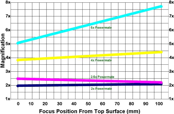

For reference, your 5x powermate was probably giving you more like 7.8x if you were using it in front of the binoviewers. So the 25mm ep's were more like 3.2mm ep's. If you use 2 5x powermates right in front of the ep's, then they are still 5x.
That's ok, though. I agree that I can see more easily with 2 25mm plossls and binoviewers than with a single premium ep. There isn't any more detail, but there is improved contrast and apparent size. I have to try A LOT harder to see the same details in cyclops viewing. Also, the image gets bigger for me with both eyes open. Weird, ain't it?

tomhole's attachment for post 75482
